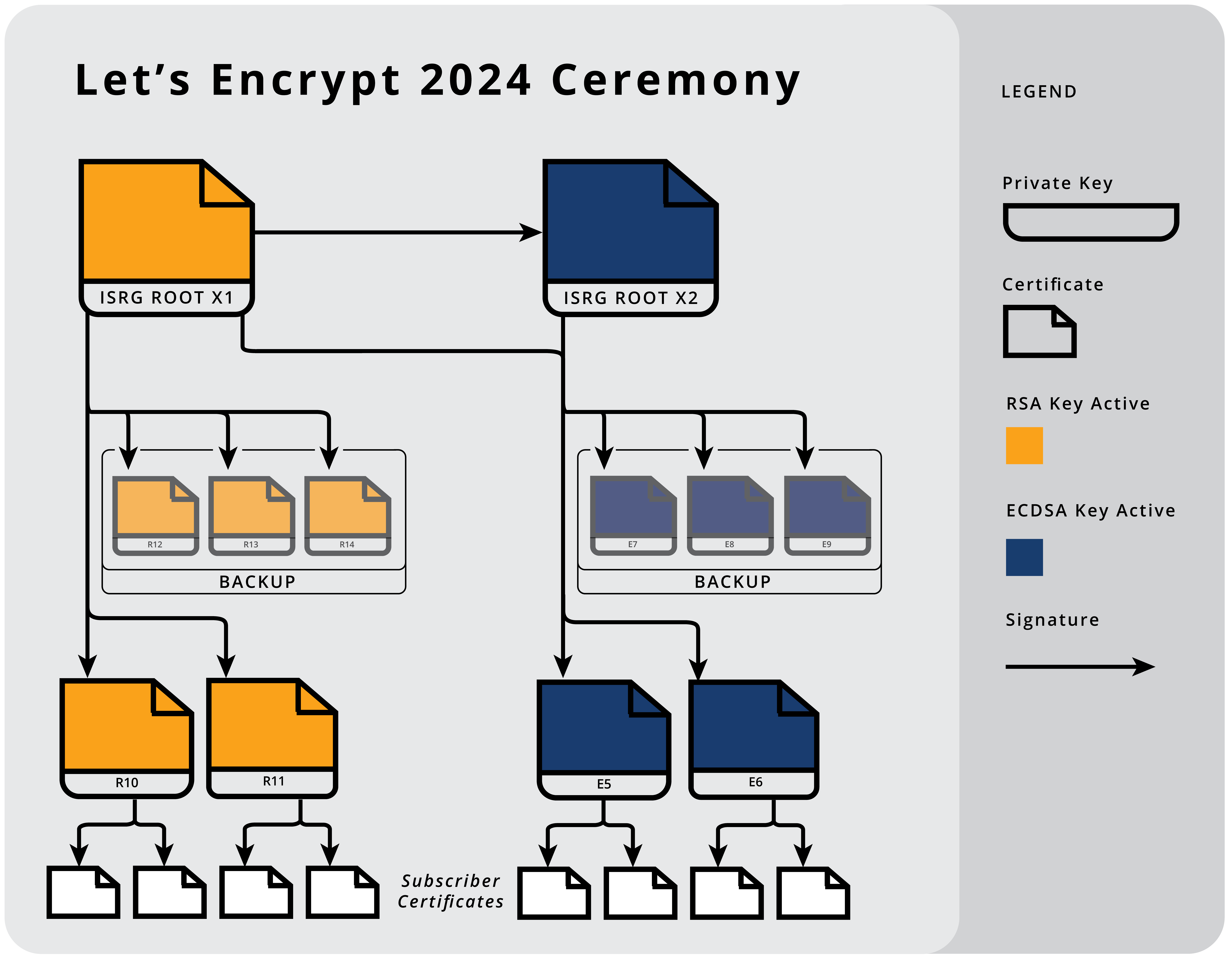

The following diagram depicts what the new hierarchy looks like. You can see details of all of the certificates on our updated Chain of Trust documentation page.
Let’s Encrypt 2024 Ceremony

All certificates - issued by both RSA and ECDSA intermediates - will be served with a default chain of ISRG Root X1 → (RSA or ECDSA) Intermediate → End-Entity Certificate. That is, all certificates, regardless of whether you choose to have an RSA or ECDSA end-entity certificate, will have one intermediate which is directly signed by the ISRG Root X1, which is Let’s Encrypt’s most widely trusted root.
The new ECDSA intermediates will also have an alternate chain to ISRG Root X2: ISRG Root X2 → ECDSA Intermediate → End-Entity Certificate. This is only applicable to a small number of Subscribers who prefer the smallest TLS handshake possible. To use this ECDSA-only chain, see your ACME client’s documentation on how to request alternate chains. There will not be any alternative chains for the RSA intermediates.
It is important to note that there will now be multiple active RSA and two active ECDSA intermediates at the same time. An RSA leaf certificate may be signed by any of the active RSA intermediates (a value from “R10” to “R14” in the issuer common name field of your certificate), and an ECDSA leaf certificate may be signed by any of the active ECDSA intermediates (“E5” through “E9”). Again, your ACME client should handle this automatically.

Earlier, the default ECDSA chain included two intermediates: both E1 and the cross-signed ISRG Root X2 (i.e. ISRG Root X1 → ISRG Root X2 → E1 → End-Entity Certificate). After the change, it will contain only a single intermediate: the version of one of our new ECDSA intermediates cross-signed by ISRG Root X1 (i.e. ISRG Root X1 → E5 → End-Entity Certificate). This ensures that all of our intermediates, both RSA and ECDSA, are signed directly by our most widely-trusted ISRG Root X1.
