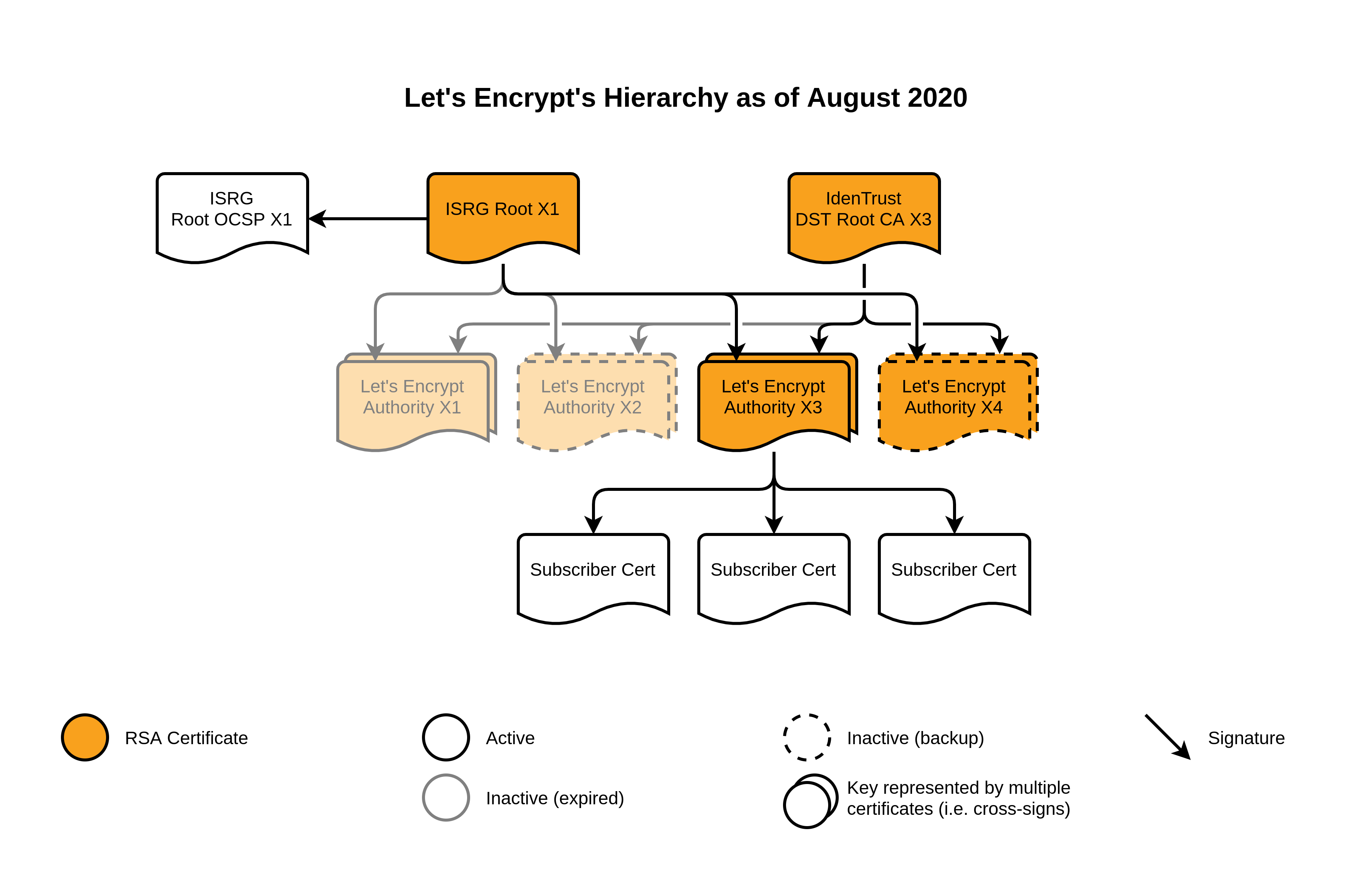

The Backstory
Every publicly-trusted Certificate Authority (such as Let’s Encrypt) has at least one root certificate which is incorporated into various browser and OS vendors’ (e.g. Mozilla, Google) trusted root stores. This is what allows users who receive a certificate from a website to confirm that the certificate was issued by an organization that their browser trusts. But root certificates, by virtue of their widespread trust and long lives, must have their corresponding private key carefully protected and stored offline, and therefore can’t be used to sign things all the time. So every Certificate Authority (CA) also has some number of “intermediates”, certificates which are able to issue additional certificates but are not roots, which they use for day-to-day issuance.
For the last five years, Let’s Encrypt has had one root: the ISRG Root X1, which has a 4096-bit RSA key and is valid until 2035.
Over that same time, we’ve had four intermediates: the Let’s Encrypt Authorities X1, X2, X3, and X4. The first two were issued when Let’s Encrypt first began operations in 2015, and were valid for 5 years. The latter two were issued about a year later, in 2016, and are also valid for 5 years, expiring about this time next year. All of these intermediates use 2048-bit RSA keys. In addition, all of these intermediates are cross-signed by IdenTrust’s DST Root CA X3, another root certificate controlled by a different certificate authority which is trusted by most root stores.
Finally, we also have the ISRG Root OCSP X1 certificate. This one is a little different – it doesn’t issue any certificates. Instead, it signs Online Certificate Status Protocol (OCSP) responses that indicate the intermediate certificates have not been revoked. This is important because the only other thing capable of signing such statements is our root itself, and as mentioned above, the root needs to stay offline and safely secured.
Let’s Encrypt’s hierarchy as of August 2020

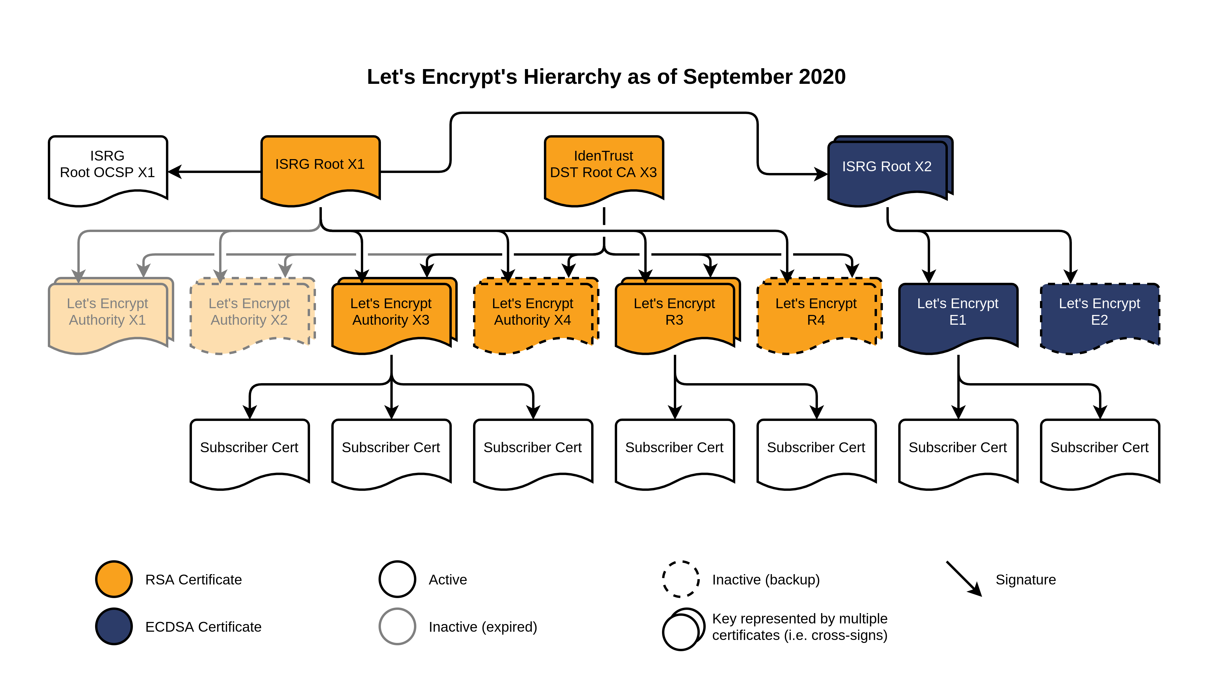

The New Certificates
For starters, we’ve issued two new 2048-bit RSA intermediates which we’re calling R3 and R4. These are both issued by ISRG Root X1, and have 5-year lifetimes. They will also be cross-signed by IdenTrust. They’re basically direct replacements for our current X3 and X4, which are expiring in a year. We expect to switch our primary issuance pipeline to use R3 later this year, which won’t have any real effect on issuance or renewal.
The other new certificates are more interesting. First up, we have the new ISRG Root X2, which has an ECDSA P-384 key instead of RSA, and is valid until 2040. Issued from that, we have two new intermediates, E1 and E2, which are both also ECDSA and are valid for 5 years.
Notably, these ECDSA intermediates are not cross-signed by IdenTrust’s DST Root CA X3. Instead, the ISRG Root X2 itself is cross-signed by our existing ISRG Root X1. An astute observer might also notice that we have not issued an OCSP Signing Certificate from ISRG Root X2.
Let’s Encrypt’s hierarchy as of September 2020
