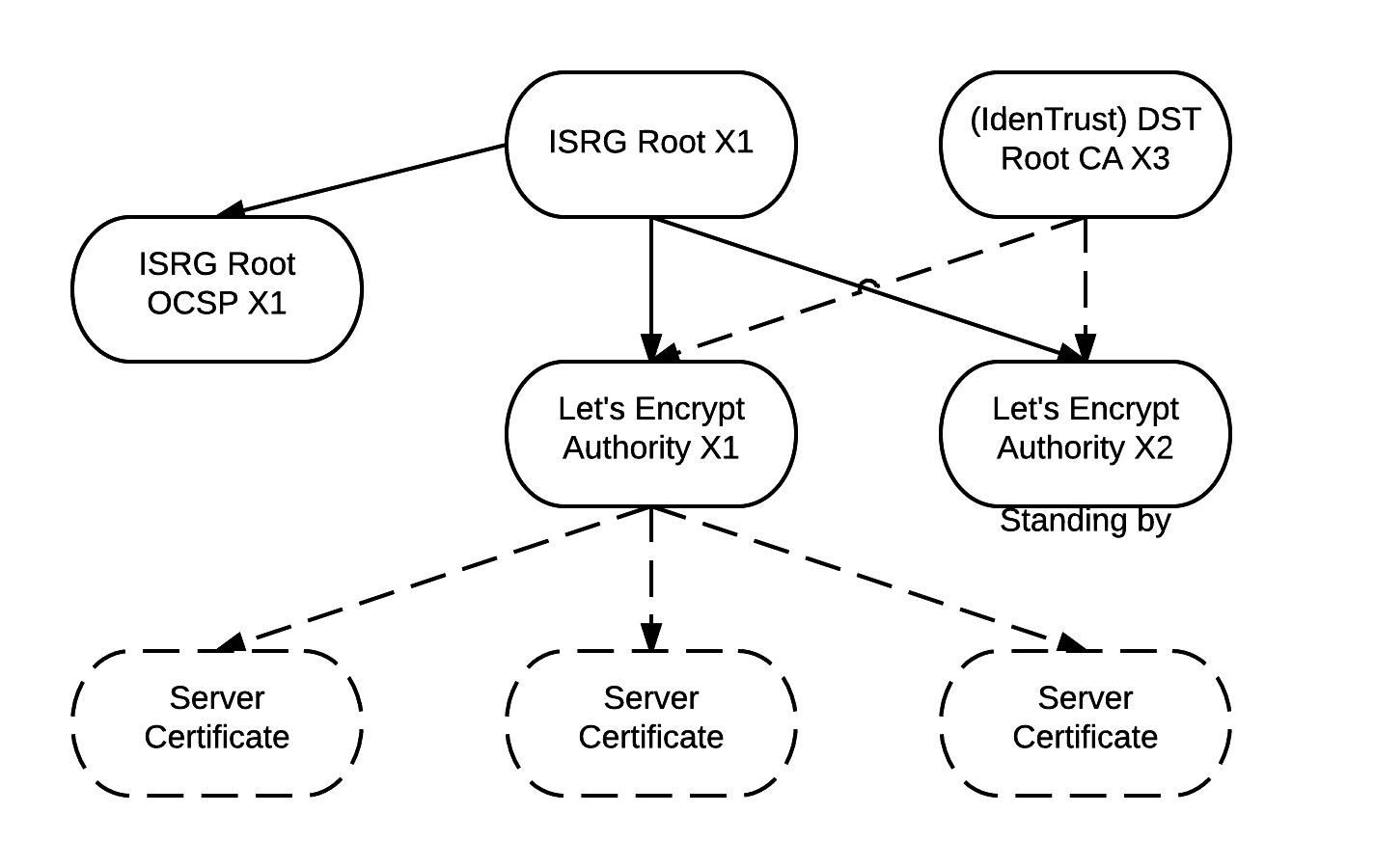

Let’s Encrypt will issue certificates to subscribers from its intermediate CAs, allowing us to keep our root CA safely offline. IdenTrust will cross-sign our intermediates. This will allow our end certificates to be accepted by all major browsers while we propagate our own root.
Under normal circumstances, certificates issued by Let’s Encrypt will come from “Let’s Encrypt Intermediate X1”. The other intermediate, “Let’s Encrypt Intermediate X2”, is associated with our disaster recovery site and will only be used should we lose the ability to issue with “Let’s Encrypt Intermediate X1”.
The private keys for the ISRG root CA and the Let’s Encrypt intermediate CAs are stored on hardware security modules (HSMs), which provide a high degree of protection against the keys being stolen.
