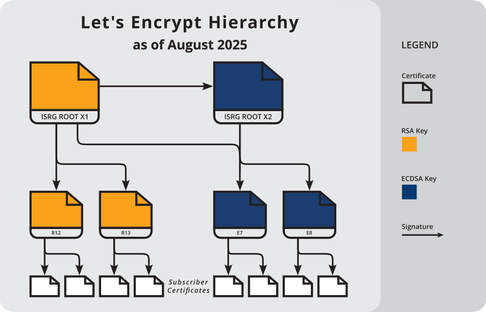

ISRG Certificate Hierarchy Diagram, as of August 2025

Chains
When an ACME client downloads a newly-issued certificate from Let’s Encrypt’s ACME API, that certificate comes as part of a “chain” that also includes one or more intermediates. Usually this chain consists of just the end-entity certificate and one intermediate, but it could contain additional intermediates. The idea is that, by presenting this whole chain of certificates to a website visitor’s browser, the browser will be able to validate the signatures all the way up to a root that browser trusts without having to download any additional intermediates.
Sometimes there’s more than one valid chain for a given certificate: for example, if an intermediate has been cross-signed, then either one of those two certificates could be the second entry, “chaining up to” either of two different roots. In this case, different website operators may want to select different chains depending on the properties that they care about the most.
Subscriber certificates with RSA public keys are issued from our RSA intermediates, which are issued only from our RSA root ISRG Root X1 (i.e. they are not cross-signed). Therefore, all RSA subscriber certificates have only a single chain available:
RSA Subcriber Cert ← RSA Intermediate (R12 or R13) ← ISRG Root X1
Subscriber certificates with ECDSA public keys are issued from our ECDSA intermediates, which are issued both (i.e. are cross-signed) from our RSA root ISRG Root X1 and our ECDSA root ISRG Root X2. Therefore we offer two chains for these certificates:
ECDSA Subcriber Cert ← ECDSA Intermediate (E7 or E8) ← ISRG Root X1
ECDSA Subcriber Cert ← ECDSA Intermediate (E7 or E8) ← ISRG Root X2
The first chain, up to ISRG Root X1, provides the greatest compatibility because that root certificate is included in the most trust stores. The second chain, up to ISRG Root X2, consumes fewer bytes of network bandwidth in each TLS handshake. We provide the first chain by default, to ensure the widest compatibility. Subscribers who wish to prioritize size over compatibility can reference their ACME client’s documentation for instructions on how to request the alternate chain (for example, certbot’s --preferred-chain flag).
